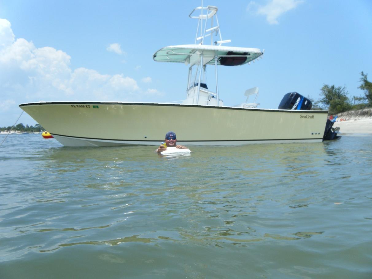

Hello,
I'm going to paint my 1974 23' SeaCraft Fighting Lady Yellow. For a bootstripe, I wanted the same size as on the newer (yr 2000+) SeaCrafts.
Does anyone with a newer SeaCraft know what size (1 inch?, 3/4"?) the boot stipe is... and what color this is? I think it is a Black Bootstripe.
The picture is the color combo I'm going for. But my older SeaCraft will have the Thicker rub rail. (See 2nd modified Picture). That's not me in the pic, BTW, but I
Love that color combo!!!

I had a 2 inch boot on my 23 and it looked OK. I changed it to a 1 1/2 and it looks great.

Just replaced mine- it's 1 1/4 inch wide the black is 1 inch and gold is 1/4

1" black !!
wider stripes will make the boat look like a tug boat !!
thinner stripes will give the ship a sleek,longer look
