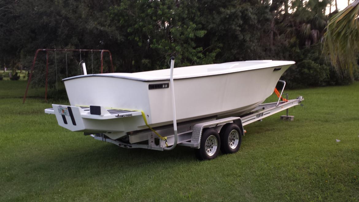

I'm pretty sure I know the answer to this but my friend though different. What length shaft motor if right for this setup? Its a 1981 (CSY) with a closed in transom and an Armstrong bracket.

pretty sure the answer is 25' ... the Hermco brackets are built for a 25' see link

25 inch sounds right to me also.
I plan on going with an older 2 stroke to keep the cost down until I get everything how I want it...This is my first project and I'll be paying people to do what I'm not qualified to do.....

Go with a 30' if you have room to move it to the top holes. Motors on brackets get pretty wet back there past the apex and the extra length will help keep her dry.

The guy who owned it was trying to turn it into a side console with some sort of storage/cuddy thing. That will be cut out to return it to a center console open fisherman. I will be looking for a local fiberglass guy to tackle that.
