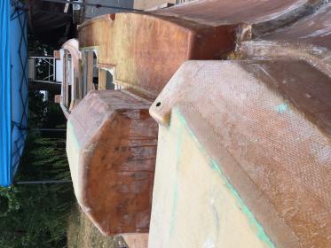

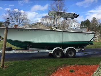

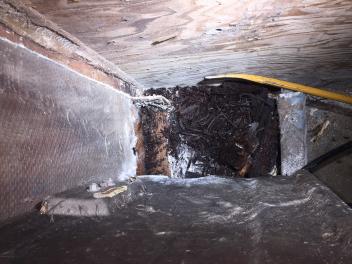

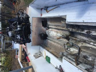

Well after may years Admiring seacraft boats I finally bought one two years ago. After many years I’m looking at them I found one down in Virginia Beach. My friend Bobby and I made a weekend trip down to Virginia Beach to look at the boat. It came with a mercruiser 454 and hurts transmission. Driving home in New Jersey the front hinges on the console ripped out in the center console was flopping around tied it down and made the rest the ride home. The first couple repairs in the first month were rewiring the boat fixing the consolel and record in the back hatch. Use the boat for about four trips and then found the gas tanks we are leaking. Pull the gas tanks out and was about to do the transom and then one thing led to another then Covid started last year. Decided to pull the whole boat apart and rebuild it. The transom and scupper blocks were mulch and the floor had a soft spot.

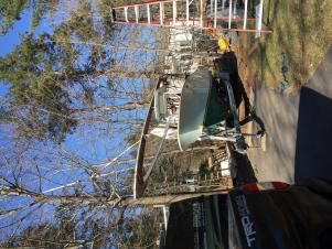

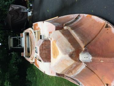

Here are a few more pics of pulling the whole boat apart.

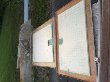

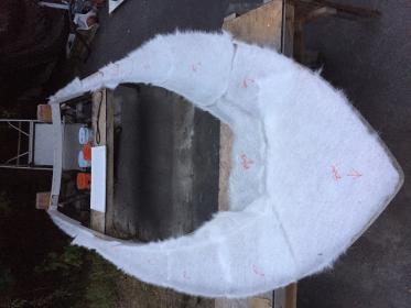

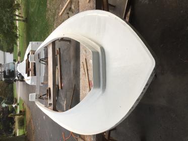

The next few pic are getting the core cut out. The core material I’m using is divinycell foam. 3/8’’ for the floor, transom 1 1/2’’ the glass I’m using 1.5 oz csm with 22oz triaxial

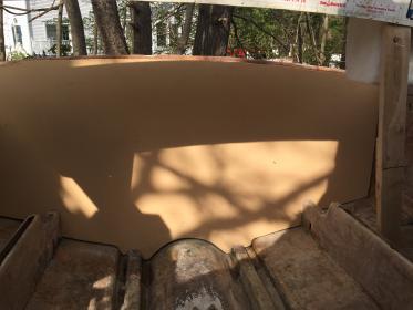

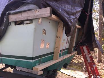

This is 1’’ and 1/2’’ divinycell with 1.5 oz csm glued together and is set in with core bond. I had to frame the outside of the transom to keep it straight i used the scupper holes to hold the bottom in. Inside the boat used 2x4s to push/ hold the core in place.

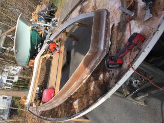

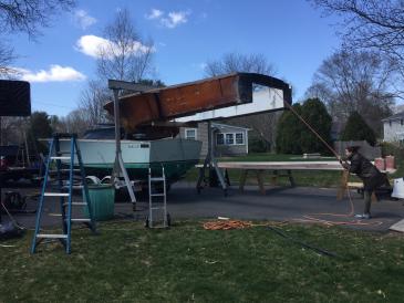

How difficult was it getting that liner separated from the hull and out in one piece? I could see that being a challenge, especially if it were bonded together well around the perimeter.

Attachment 23525
It was kind of tough to get out. I used wedges that were 3 to 5 feet long and were 6’’ tall. I spend a few day looking at every seacraft inboard model they made. I found this one build and looked at were the potter putty was. You can see the bow of the boat was cut. I had to send the wedge down the bow to separate the two. Also there was putty between the well and keel which my well got broken but i fixed that.
