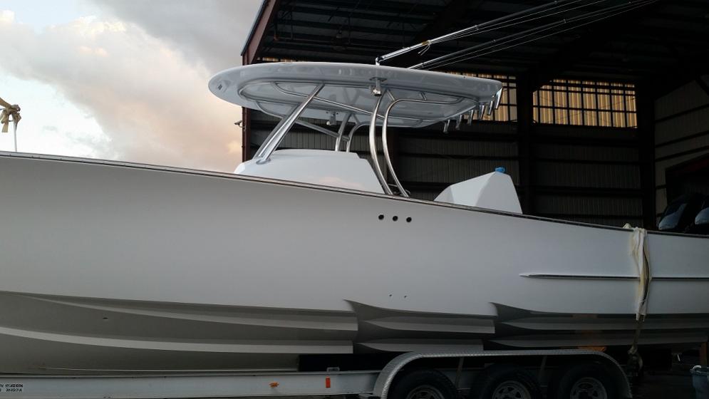

Top is on today but still much more to do, new props are next. Thinking standard 28" Bravo 1's hopefully will bring her up to 6400 rpms when the superchargers can take over and push us to 7000+...
