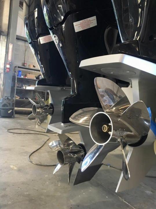

What props were you using when you got the 86.6?
I know I'm asking a lot, but if they're custom, could you give blade #, pitch, diameter, cup, and rake progression information?

Fr. Frank,
We have been running Mercury racing 30" MAX5's from day one which are way to much. We'll be trying everything we can from 26 to 28" once we can get some on loan. Standard Bravo 1 and Bravo FS along with a smaller MAX5 is the direction we are going.

Top is on today but still much more to do, new props are next. Thinking standard 28" Bravo 1's hopefully will bring her up to 6400 rpms when the superchargers can take over and push us to 7000+...
